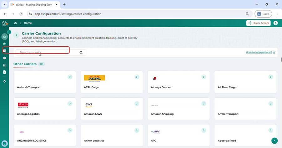

Step 1 — Open Carrier Configuration and search for the carrier
Go to Settings → Carrier Configuration. Use the search box to type the carrier name (e.g. "blue").

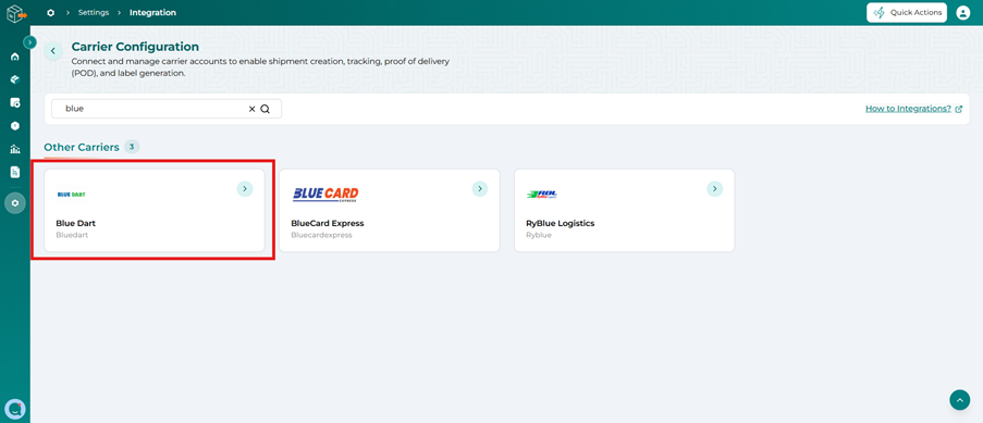

Step 2 — Select "Blue Dart" from the filtered results
Typing "blue" narrows the "Other Carriers" grid to Blue Dart, BlueCard Express, and RyBlue Logistics. Click the Blue Dart tile to start the setup wizard.

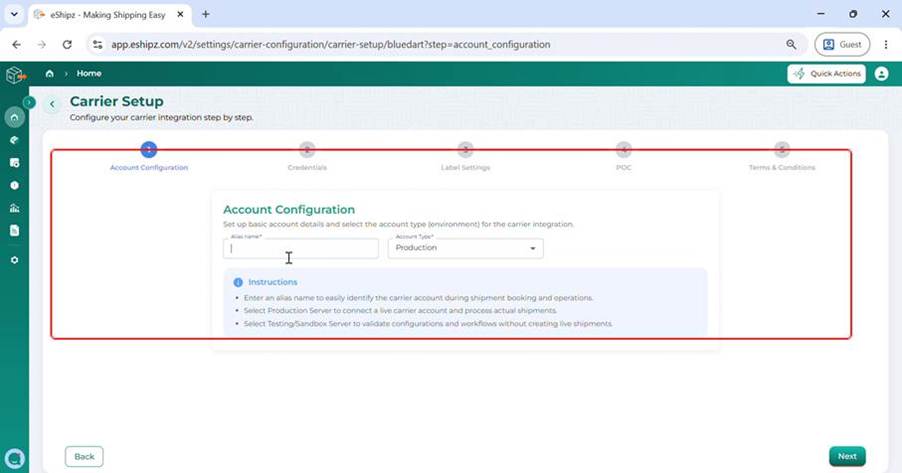

Step 3 — Fill Account Name
On the Account Configuration tab, enter an Alias Name to easily identify this carrier account during shipment booking and operations, and select the Account Type (Production or Testing/Sandbox).
Click Next to continue to Credentials.

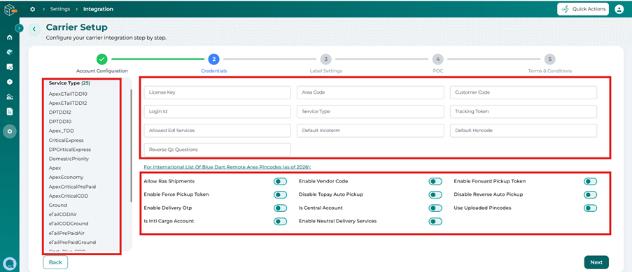

Step 4 — Configure Credentials & shipment behaviour
The Credentials tab shows a Service Type list on the left
Note : The Credentials will be given by the carrier team as per the aggrement or Contract made by the customer.
Ground,      `
Apex,
ApexEconomy,
DomesticPriority,
CriticalExpress,
DPTDD
eTailCODAir,
eTailCODGround,
eTailPrePaidAir,
eTailPrePaidGround,
select the service(s) you want to enable which are already available in the side panel.
On the right, fill in the following fields:
•     License Key
•     Area Code
•     Customer Code
•     Login Id
•     Service Type
•     Tracking Token
•     Allowed Edl Services
•     Default Incoterm
•     Default Hsncode
•     Reverse Qc Questions
A link “For International List Of Blue Dart Remote Area Pincodes” is available just below these fields for reference.
Set the following toggles based on your operational needs:
Setting
What it does
Allow Ras Shipments
Allows delivery to remote-area pincodes (this may add an extra remote-area surcharge). A link below the checkbox lets you look up the remote-area pincode list.
Enable Vendor Code
Passes a unique ID to Blue Dart for billing identification — useful if you have multiple pickup locations.
Enable Forward Pickup Token
Auto-schedules pickup for forward shipments created.
Enable Force Pickup Token
Auto-schedules pickup for every shipment created.
Disable ToPay Auto Pickup
Turns off automatic pickup scheduling specifically for ToPay shipments (auto-pickup is on by default).
Disable Reverse Auto Pickup
Turns off automatic pickup scheduling for reverse shipments (auto-pickup is on by default).
Enable Delivery OTP
Sends an OTP to the recipient at delivery, used to confirm delivery.
Is Central Account
Enables all-India pickup as a forward shipment from any location (otherwise Blue Dart only ships from the registered warehouse, unless you use "ToPay shipments" for other locations).
Use Uploaded Pincodes
Uses the pincode list you've uploaded instead of the carrier's default serviceable pincodes.
Is Intl Cargo Account
Marks this account as an international cargo account.
Enable Neutral Delivery Services
Enables neutral (carrier-agnostic) delivery service options.

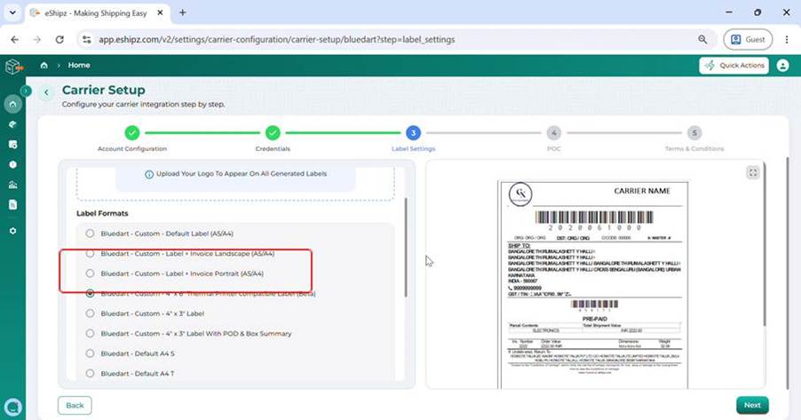

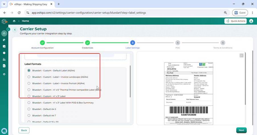

Step 5 — Choose a Label Format (Optional — as per your preference)
This step is optional and entirely based on your preference. Under Label Settings, pick the label layout you want. Click "How does it look?" next to any format to preview a sample. If none is selected, eShipz defaults to the Blue Dart Custom – Default Label (A5/A4) after the shipment is created.
Uploading a logo: Above the label list, you can browse and upload a PNG/GIF/JPEG logo. This only applies to the Custom – Label + Invoice (Portrait/Landscape) and Custom – 4"x6" Thermal Printer label formats — otherwise labels print without a logo.

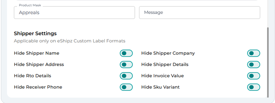

Shipper Settings (further down the same tab) let you hide specific details on the printed label:
•     Hide Shipper Address / Name / Company / Entire Shipper Details
•     Hide Entire Return Address
•     Hide Invoice Value
Step 6 — Set Product Mask and Message (Optional)
This step is optional. If left blank, defaults will be used.
•     Product Mask — Enter a value here to display a generic name on the label instead of the actual item being shipped. If left blank, the actual item name is shown on the label by default.
•     Message — Text entered here appears at the bottom of the label. If left blank, no message is shown by default.
“Shipper Setting”

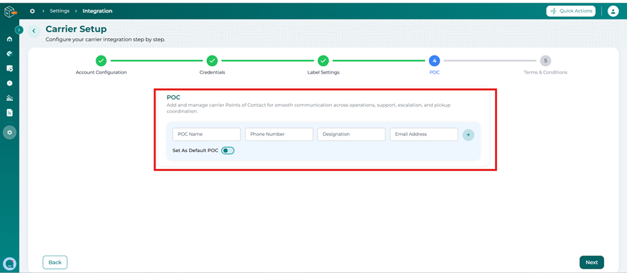

Step 7 — Add a Point of Contact (Optional)
This step is optional. On the POC tab, you may add the name, phone number, designation, and email address of the contact person for this carrier account (used for operations, support, escalation, and pickup coordination). Toggle Set As Default POC if this should be the primary contact. You can skip this step and add a POC later if you don't have the details on hand.

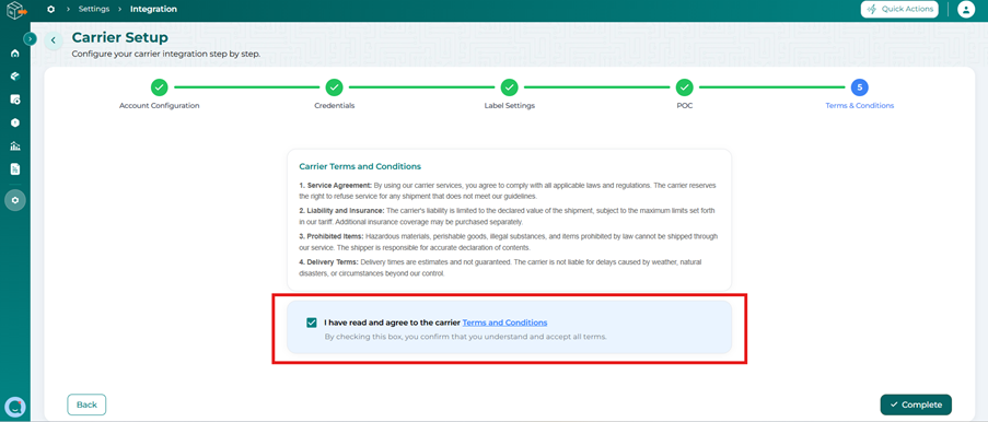

Step 8 — Accept Terms & Conditions and complete setup
Review the Carrier Terms and Conditions, check "I have read and agree to the carrier Terms and Conditions," then click Complete.

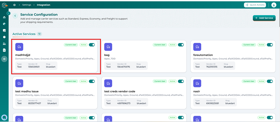

Step 9 — Confirm the account is active
Once saved, eShipz shows a "Service added successfully" confirmation and takes you to the Service Configuration summary, where all five setup steps (Account Configuration, Credentials, Label Settings, POC, Terms & Conditions) show green checkmarks. Two additional optional sections are also available here:
•     Pincode, EDD & AWBs Uploads
•     Freight Audit Settings
Finally, the Blue Dart account appears as an Active service under Service Configuration → Active Services, ready to use for shipment creation.
You can now create shipments using the configured Blue Dart carrier.
