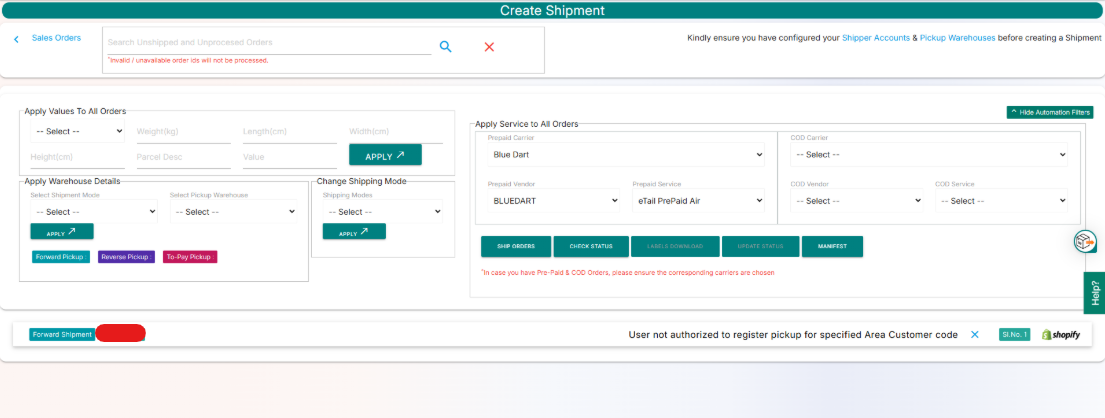

how to handle the error - “User not authorized to register pickup for specified Area Customer code” for bluedart carrier?
This error occurs when the customer sender state does not match the customer area code in the carrier configuration page.
How to handle this error?
Please ensure that the customer sender state matches the customer area code on the carrier configuration page.
